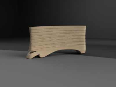

ruben_van_lerberghe
Hello @TrippyLighting
I was able to copy the steps you did in the youtube video 🙂
From there I tried to model the missing parts, being the feet:
-On the right it's not very far from the shape in the sketch, it needs to be a little rounder and the top should be more aligned with the bottom of the band above.
- In the middle I tried it differently ( with a plane, then thicken and then mirror). I think you can get an idea of what I try to do ( a sweep from front to back)
- on the left : the band coming down as you modelled. However this also is a sweep from front to back and so it should be open like the middle one.
And then those 3 parts should be united as the bottom body.. I had a go at merging edges but did not get anywhere.
The upper body then consists of the 6 top bands plus on the right a part of the 7th. So i wonder how I can connect these bands best into one solid body. Since it's a piece of furniture, those bands can't just be floating but are wrapped around a center part, keeping the shapes looking as they do now.
So at the end, I would have one body for the top and one for the feet. At 220mm height is where they meet.
Any advice how to take it from here? I attached the model.

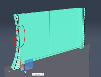

Just noticed that when I extrude in box-mode it all looks fine but in smooth display mode, something twists..
Scherm­afbeelding 2024-01-07 om 20.44.02.pngScherm­afbeelding 2024-01-07 om 20.44.06.png
Message 18 of 21
TrippyLighting
Please share the model.
Message 19 of 21
ruben_van_lerberghe
Here is the model, I already extruded it so you can see that 2 of the faces twist.
Thank you @TrippyLighting
Message 20 of 21
TrippyLighting
You created a lot of overlapping faces. Those need to be eliminated:
