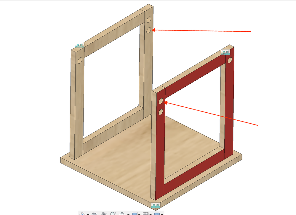

@brady5acct - thanks for the reply.  The one question I have about your design vs mine is:  Do you intend for these sides to be reversed like this?  That is:  the "BackStile" on one side (the one with two holes) is actually located in the front in the copy:
I had assumed that the intent was to line up the two sets of holes (maybe so that a rod could be inserted into both of those holes?), and this is why, for my design, a sub-assembly would not work, and why I flattened out the design into just a collection of parts in the top-level assembly - it allowed me to rotate the parts, and keep the front/back aligned.  If this orientation is OK, then your approach is much better, because it does indicate that it is composed of two sub-assemblies.
Re:  BOM.  I admit I am not a drawings expert, much less a BOM expert.  I know that the current Parts List is limited.  I have heard a lot of praise for this add-in:  Bommer as a more-powerful alternative.  I suspect (though I do not know this for a fact) that Bommer would be able to give you accurate part counts in your sub-assembly case.
There is one more approach here that is more complex, but does preserve the sub-assembly.  I think it will work.  If I have time and motivation tonight, I may give it a try...

Good catch Jeff  - you're right. The BackStile was mistakenly put in the front by my attempt. I see now why you did what you did in your previous reply. If only there wasn't something more like what mirroring does w/o its BOM shortcomings.
Rich
