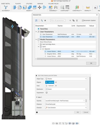

jhawkinsRXEMB
Am I correct that it is still not possible to use a driven dimension in a formula? I am trying to set a parameter to the max of a calculated value or a safe minimum. I.e. max(myCalculatedValue;drivenDimensionThatExpressesTheSafeMinimum)
I get errors using the driven dimension like this, whereas it works if I just throw a number in to confirm the formula syntax. Is this expected, or am I missing something?
Message 48 of 48
laughingcreek
@jhawkinsRXEMB wrote:
Am I correct that it is still not possible to use a driven dimension in a formula?...
you can use driven dims in formulas, even the max formula.  you still have you manage your units though.
