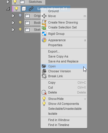

If you've imported the design it will be a linked component, if you right click it in the browser you can select Break Link then it will behave like any other component. If you break the link any changes to the original external design will not modify the version in the design you imported it in to. If you want to keep it linked you have the option to right click and select Open to edit the external file, when you save and close you will be prompted to get the latest version.
