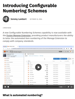

I am not exactly sure what you want to change on each body but if you have the Fusion Manufacturing Extension
you might be able to customise it with this.
