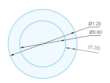

Dimensioned drawing enclosed.
Yes, the 'annular' circles are small at 1.2mm outer diameter and 0.8mm inner diameter, but this leaves the shell of the baubles as 0.4mm (1.2 - 0.8). and since this is the same thickness as the shell of the tree then the slicer should not see this as an issue?

Edit: maybe I'm missing something...but your PDF tree has a 0.4 mm shell, but your Cura preview has a full bottom layer. Nevermind, I was missing the Fusion image.   😶
From that image, it seems the balls have a small shell.
If you have 1.2 mm outer and 0.8 inner diameters, you will have a shell of 0.2 mm in "each side" of the circle.

Ah Leonardo - how embarrassing!
I mixed up my radius and diameters, didn't I....
You are quite right - I was thinking I had a 0.4mm concentric shell when I only had 0.2mm.  Slicer diagram attached shows two baubles as per original design, and two with corrected shell thicknesses. Cura fails to see the two that are too thin (for current settings) but sees the other two.
This is a good result for me because it means that I can continue to base designs on SVG files.
