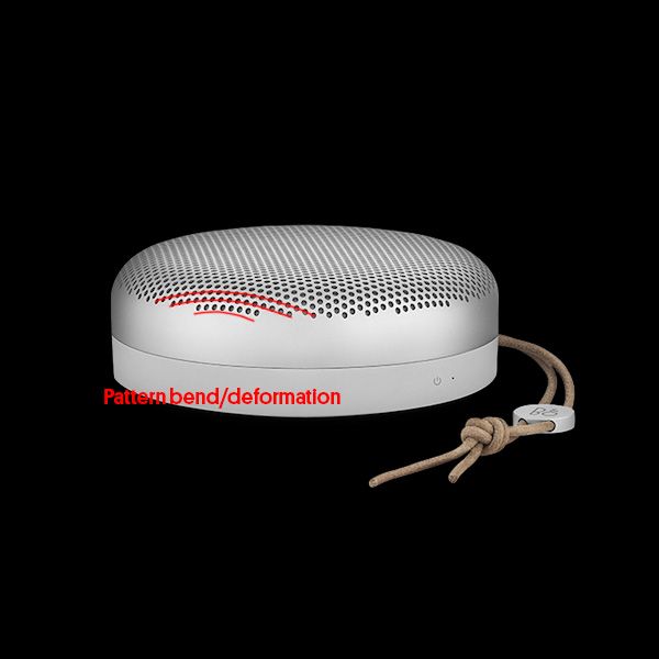

my first post here, so far loving the Fusion360.
I am trying to model this speaker. Not so complicated mesh but I am having a problem with evenly spaced out holes mainly in curved area. Image below shows photo of the product [left side] and my model [right side].
I found this forum thread from which I adopted the workflow.
https://forums.autodesk.com/t5/fusion-360-design-validate/multiple-holes-on-a-complex-surface/td-p/6...
First I create a sketch pattern of desired point positions. Then I project it on surface in Z axis on the surface. After I create "Axis perpendicular to Face at Point". And from there I align the objects with which I cut out the holes. Workflow works fine, but in the curved areas I get uneven spacing between the points. I understand that projection along the axis gives me this result. I tried other variations of surface projections with "closest point" option with different positions of base points but nothing gives me the good result.
Is there any way to overcome this issue? I briefly looked at "Sheet Metal" tools, if I can find anything useful there. But I was not successful . I would appreciate any help. I spent too much time solving this problem, until now I did not find any good solution.

Pattern on a Path is only available as a Modelling feature, which is the clue to that red model from Donsmac.
Sketch the Path, and project to the top surface.
Pattern Spheres on that path, and cut the surface with them,
thicken the surface to make a solid body from there.
Might help....

From top view photograph of the product is visible that pattern is deformed/wrap a little. This is probably due to manufacturing process. Where at first the holes are drilled onto the straight metal sheet and afterwards bend to the shape. This is similar to my initial workflow, but in my situation I was projecting the points in one axis which created the uneven pattern. But in manufacture they are bending not projecting [as I think]. Is there any way how to simulate this kind of bending with the Metal Sheet tools or other?
g-andresen
take a look a t some tutorials and create a sheet metal body.
