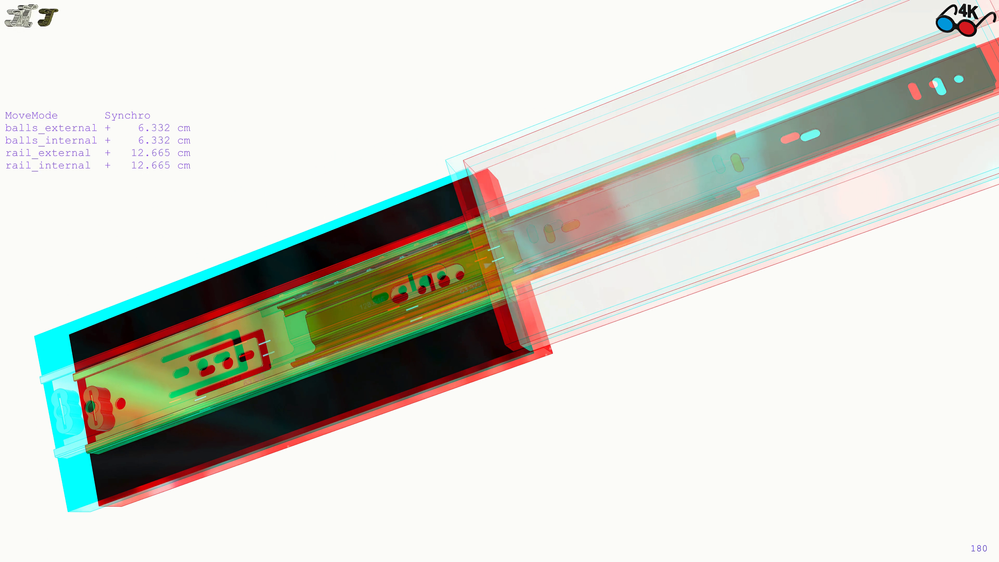

Hi Herr Walter Holzwarth,
Here it is … the file modelling of a drawer slide with an extension, as well as mp4 video files showing animations of two modes of its movement.
The file’s model is configured as ‘synchro’ ; slide joints are 1:1 synchronized.
In the video file, you will find, perhaps more realistic ‘sequeo’ mode of movement.
How can ‘sequeo’ be encoded into the model’s joints?
The users of Fusion360 love challenge, and particularly the Fusitzens of this Forum, don’t they?
 … thus, the denial of the opportunity to find out how, would be on my part … very brutal constrainment of curious minds.
I can’t do that! … so, I will rest the question unanswered.😣

DrowerSlides_mono.png     4K_mono      (  2MB)    https://a360.co/3ftdVMn
DrowerSlides_mono.mp4    4K_mono      ( 17MB)   https://a360.co/3A3soYO
DrowerSlides_arcd.png       4K_stereo     (   4MB)   https://a360.co/3qwA6rd
DrowerSlides_arcd.mp4      4K_stereo      ( 57MB)  https://a360.co/34LeEWT
DrowerSlides_al.mp4          4K_stereo      ( 38MB)   https://a360.co/3GzuUsg
DrowerSlides.f3d                 F360_model  (0.6MB)   https://a360.co/33HL7g8
To be viewed on 4K media devices (monitors, UHD TVs, projectors...) of reasonable performance. For the best experience, use stand-alone media applications (WMP, VLC) and the native resolution 3840x2160 - full screen. The '_arcd' files require an anaglyph red/cyan glasses, while '_al' is for an active shutter glasses 3D hardware (~30 deg viewing angle is recommended) . Download the files over a network, where the cost of doing so is not a concern. The files are to be used for private, non-commercial purposes only.
