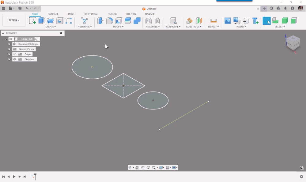

The only way I can do it is to Press Okay, and then select the Revolve from the Timeline, and then add another Profile, then Press Okay, then select the Revolve from the Timeline, then add another Profile, etc. Can't do it in one step?
My design is not the issue, I am able to recreate this with basic shapes.

I'm on macOS and things seem to work fine. Can you post a video to see if you're selecting something in a different way?

Once you have a preview (that is, you have selected a profile + an axis), you must re-activate the Profile selection widget in the dialog, and hold down CMD (CTRL on Windows) to add additional profiles.  All Fusion profile-based commands work this way.
