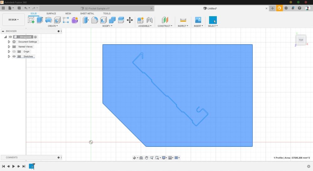

I'm trying to extrude without the profile in the middle, but I am not able to do it. Kindly help.

use divide-and-conquer to find the problem:
Screen Shot 2021-09-21 at 10.15.21 AM.pngScreen Shot 2021-09-21 at 10.15.49 AM.pngScreen Shot 2021-09-21 at 10.16.19 AM.pngScreen Shot 2021-09-21 at 10.16.45 AM.png
In the end, there is a small gap here - fix it with a coincident constraint:
repaired design is attached, FYI

Thanks for tip "Divide and Conquer". Worked like charm. Thank you Jeff.
