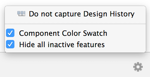

"I was under the impression that when you activate a Component and do operations on  it, those operations are INSERTED or ADDED to the timeline OF THE COMPONENT."
No, this is incorrect.  The "Hide all inactive features" setting:
Is only a filter on the timeline.  It does not change the end-of-design marker (insertion point) at all.
There are many reasons for this.  The main one is that there is no guarantee that the features for a component are even located together in the timeline (although this is definitely a best design practice, and one I try to do when I can).  So, if you want this behavior, you will have to roll the end-of-design marker to where you want it before you activate the component.

When you activate a component, the timeline doesn't move.  You can see this if you deactivate "hide all inactive features".
Like you, I like just seeing the features associated with the active component, so I leave this checked.
WHEN i remember, after activating a component I select the last feature, right click, and select "roll timeline marker here".  In your example when you do this you will notice component Y disappears from the browser, because the marker is being rolled to before it was created.
When I forget, I'll grab any newly created features and drag them forward in the timeline so all the features for a single component will be together.
