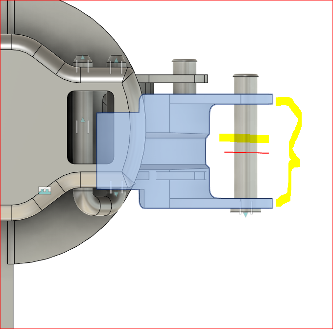

Hi All!
I feel like I'm so close but I can't get the last pin in this hinge to actually have two points which it needs to lock to:
https://a360.co/4o3LTYY
I'm following this tutorial and trying to get my hinge moving - The front part moves as expected but the last piece of the puzzle is this piece that then needs to be associated with the pin and cylinder/move. I try to assign the joint but it ends up rotating the main rear hinge body which should be fixed in position... I'd love some advice to get around the quirk! I was also wondering how people are then routing out the body to position the recessed hinge in place in the right geometric shape? Sorry for all the newbie questions! https://www.youtube.com/watch?v=vg2q-Qm_4D4

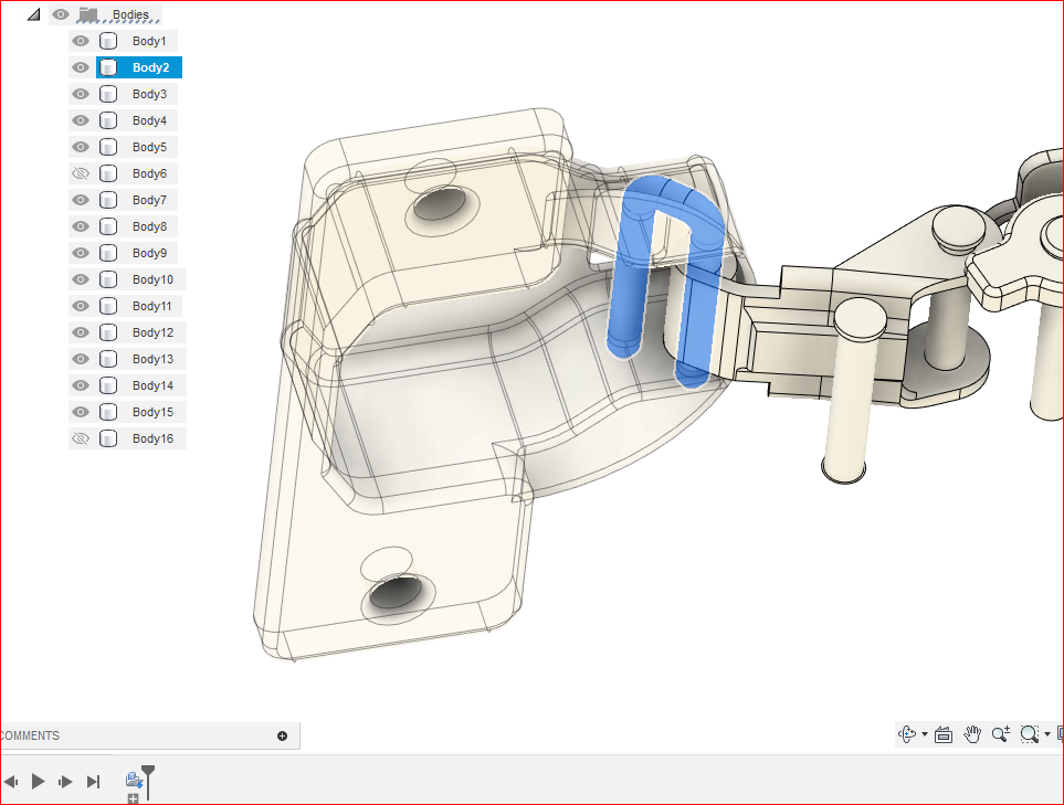

Looks like you have the first joint on Body 15, connected to the wrong leg of body 2.  That would not work.
As for Q2, the portion of circular face plate is a nice round pocket, 11mm deep, (base of body 1 will sit on the floor.)
however, there is still some interference with these 2 sets of fillets, but easy to create that clearance with manual tools.
Might help....

I picked the McMaster-Carr part number off of your shared file and downloaded it.  First thing to do is select all the bodies of the hinge and right click and select Create Components from Bodies.  Then it is pretty ease from there to create a Rigid Group off all components that do not need to move and use As-Built Joints on those that do.  Assembly is attached.

You are using Cylindrical Joints, harder to set up.
First look, these two components are not centered, cylindrical?
Only needs a Revolve on each end of Component 8 and 17.
Rigid Group the door parts, (2), and the Cabinet side (the rest)
Pin or Ground the Cabinet side, (one of the components)
I used As Built to keep the supplied alignments.  (Easier by far)
Might help.....
