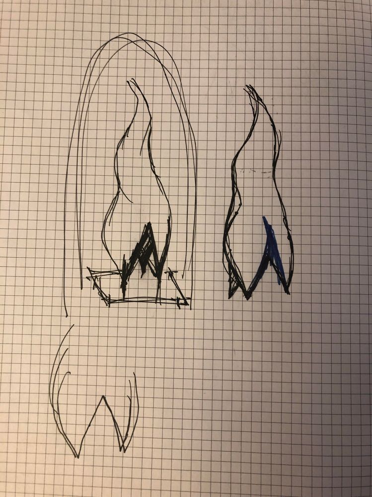

I'm currently stuck on a solution to creating negative space or removing a certain area from a shape. I've attached some sketches to explain what I'm trying to accomplish.
Currently I've been trying to create a sketch with the outline, and then projecting it onto the shape where I can then start to attempt at removing space from the body. You can see on the stretched sphere to the right of the shape an idea of this.
Basically, I'm having issues even getting the projected drawing, using split face, onto the main drawing (the flame). My idea is that it's because when I'm in model mode, the flame turns into larger faces with no splines, while the stretched sphere still includes more faces/splines.
If anyone has ideas on how I can solve this split faces issue that'd be great.
Even better: If someone understands what I'm trying to do according to my drawing, I'd appreciate any ideas or guidance on how to go about doing this.
Here's a link to the file: https://a360.co/2SzIUMI

I have a sketch attached as to exactly what I'm trying to make. I've already made the flame part, but now I'm trying to remove pieces at the bottom to create those additional triangles that are the negative space. If you refer to my sketches you can see what I'm trying to do. Please let me know if you need more information though.
That sketch is an incomplete representation of the 3D model you have in your mind 😉 It describes how the surface looks from the inside. But if you cut through a solid volume you'll have some faces on the inside. Thus I'd need to know how you want for that to look like.
@Anonymous wrote:
... So I was wondering if it was because of the increased amount of faces that allowed it to be projected onto it....
No. Also, projecting this sketches onto the surface into another sketch also is not going to help you removing these shapes from the volume.
Instead of projecting you should split the surface directly with the sketch.
I've tinkered around with this a little.
Let me know if this is close to what you are looking for.

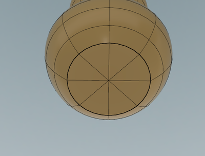

Do not project from a T-Spline body into a sketch.
Make sure the sketch is clearly bigger than the body you are citing away from.
