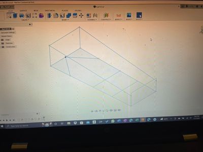

I’m trying to design my own version of a chassis and when I try to turn my initial sketch into a 3D chassis that’s where I’m running into my issues. The dimensions of my sketch are meant to be the inside edges of the tubing except for the bottom which the tubing would need to come inward toward the driver. The first picture is the one I’m basing mine on, the second is my sketch in fusion 360, and the last I drew on inventor before I got fusion 360.

TrippyLighting
Please share your model (export as a .f3d file and attach to next post.
Windows and macOS have built-in screenshot tools. Please use those instead of cellphone photos.
TheCADWhisperer
Shift Win S and Ctrl v on Windows machine for screen capture.

These are 2 sperate files. the 3D sketch was the one I was having issues with and the second is the one where I went back and spaced everything out so the inside dimensions were what I need them to be.2022-07-17.png

wersy
I don't see the need to use a 3D sketch for the pipe design.

liljohntyler
I was just hoping using the pipe function would make it easier to dissect each piece and have all the dimensions I need when I go to build it
TheCADWhisperer
It looks like you have merged together bodies that should be separate.
If you have access to Autodesk Inventor Professional - is there a logical reason you are not using Frame Generator for this design?
