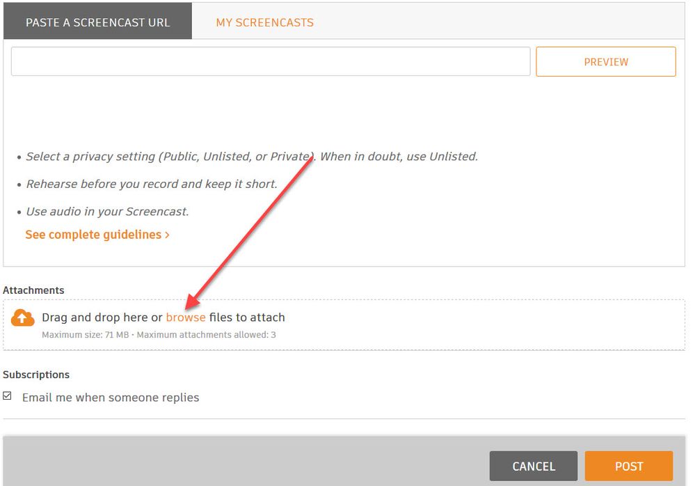

jhackney1972
Screen Captures are great but the forum users really need your model to give you a good relevant answer.  Please attach it to your question.  If you do not know how, open the model in Fusion 360, select the File menu, then Export and save the file to your hard drive.  Then use the Attachments section of a forum post to attach it.

jhackney1972
Your file is not attached.  When you Export, the resulting file should have a .f3d extension.  That is what you want to attach.
