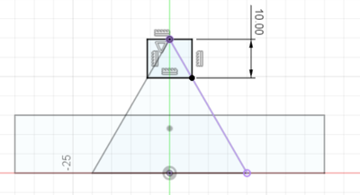

Hello, I have been practising some shapes. I did majority of the designing. I still can't figure out how to make the top view. Attaching a SS and fusion file below. Help will be appreciated as well as some explanation. Screenshot 2020-10-14 221503.jpg

You should fully define you sketches...
Constraining sketches is usually covered in the first 20 minutes of instruction.
https://youtu.be/Uf1FUCs-dNw

TheCADWhisperer
@Anonymous wrote:
Hey thanks for the help but can you show me a video of the problem I showed you specifically?
I posted the completed file - simply step through the Timeline and reproduce each step.
Ask questions if you have trouble on any step.
One small question, Do the holes go from the top and bottom? Like there will be opening at the bottom?
@TheCADWhisperer
TheCADWhisperer
The holes go all the way through.  (see my file Attached below - Extrusion #4)
