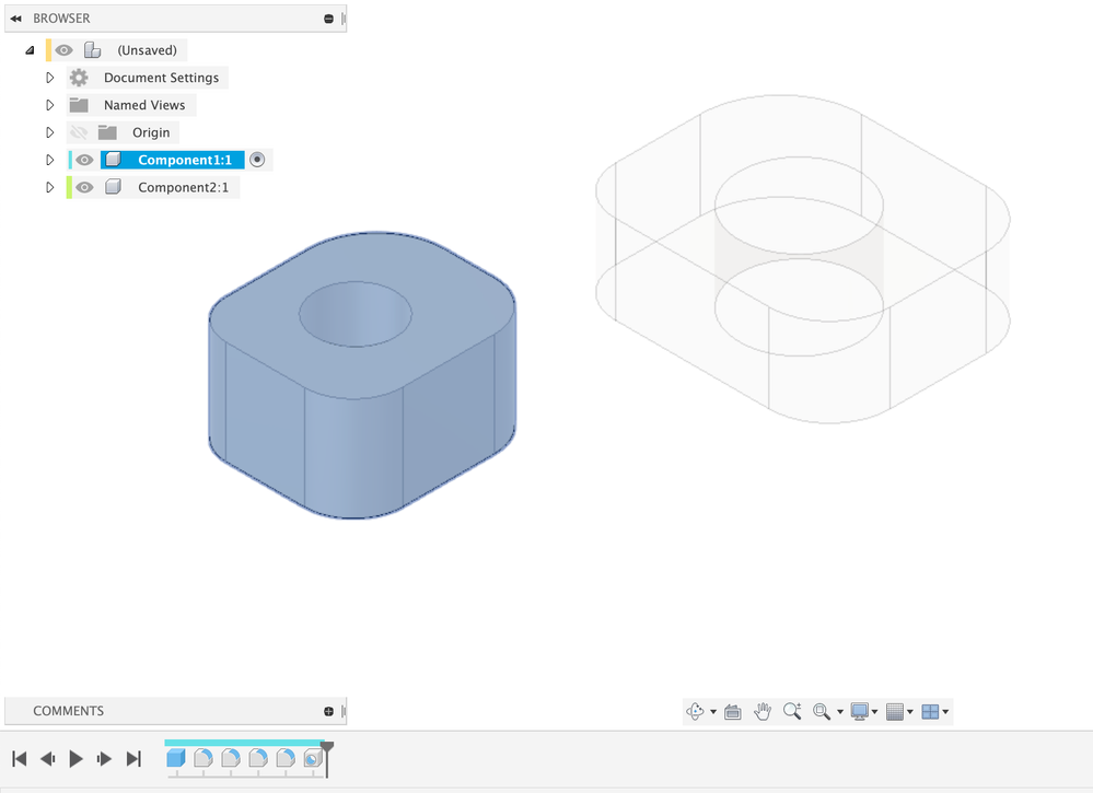

Hi, my design timeline has gone a bit weird. I have a dozen or more complex components that I have worked up sequentially and logically. Over the course of the project I've needed to revisit some bodies within components, sometime making quite substantial changes. I'm now finding that the timeline is all over the place. The actions for some bodies, instead of being together in a straightforward sequence, are scattered across the timeline and the  components are no longer in the original logical sequence. Is that normal?

@kevinwilcox46 - This is just a wild guess:  do you have this setting enabled (it is the default, so it is possible):
And, if you do have this enabled, do you regularly activate a component when you add features to it?  If so, this setting can be confusing, and can lead to the symptoms you describe.
When you activate a component with this setting, Fusion filters the timeline so that it only shows features that are owned by this component.  However, all the other features remain exactly where they were, and the "insertion point" remains where it was.  So, it may look like the features for the component are nicely grouped, even if they are not.
Here is an artificial example to illustrate.  Two components, and I've purposely mixed the features for them:
but, if I activate component1, it looks nice and tidy:
but, the timeline is really in the same state as it was before.  New features added will go at the end of the timeline, not at where it appears that the end of the timeline is here.
I apologize if that is not your issue, but it sounds from your description as if it could be.  Worth checking.

Many thanks Jeff, that's the culprit; and all down to me having read about that functionality in the tutorials but not understanding the relevance, as at that time I had no large, complex timeline to see it in effect. I'll know from here on that I need to check and place the insertion point first before editing in the component. For the rest of this file I guess I'll just have to work around the result, it's not a big problem, just makes work a little harder and a little slower.
