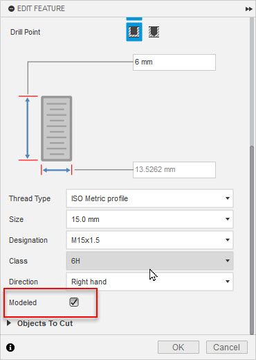

Threads show on my 3d view but when I export file for printing (.step file), the item prints, I have the hole but the hole is smooth and there is no visible threads in the hole. Im attaching a picture of 3d view as well as the .f3d file and a picture of the printed part showing smooth hole (no threads).
Thanks for any help.

Threads must be set to the "Modeled" if you want to 3D Print them.  Cosmetic threads, default, will not 3D Print.  Model is attached showing modeled threads.
