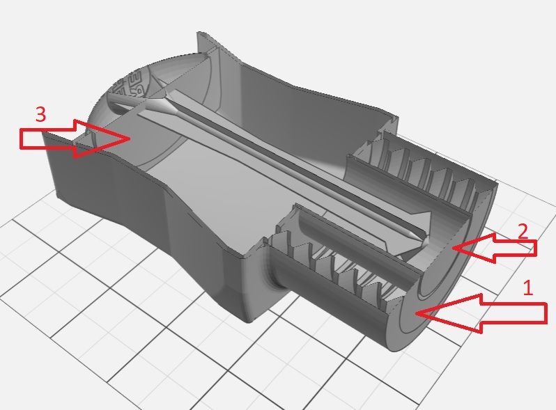

I have similar problem with my drawing.
Is there any Fusion 360 gurus who can help?
I learned Fusion 360 last weekend and created a special bottle (figured below).  In Fusion 360, the top of the bottle looks ok, but when it is rendered in STL, there exists an unintended wall at the top (arrow 1 in figure).  Also the center top circle wall (arrow 2) shouldn't be there as well.  Also there is a wall (arrow 3) that I cut out using extrude tool but it still appears.  I tried to rearrange the history to fix these two problems as recommended but it didn't help.
I am attaching fusion file below.
Thanks in advance for your help!

TheCADWhisperer
There is something wrong with your attachment (it is only 22k).
Go to File>Export to save your file locally as a *.f3d file and then Attach the file here (you might try File>New Design from File to open it yourself and verify before Attaching again).
Are all of your Sketches fully defined (I will wager that the answer is No)?

kgtjan
Oh I think there was a problem while exporting the file.
The new file is attached.  It seems the file is much larger now.
Thanks a lot!

TheCADWhisperer
@kgtjan wrote:
...The new file is attached.
I saw quite a few issues with your design.
My advice would be to start over from scratch using what you learned from this attempt to improve the design and the modeling technique.
1. Particularly - Fully constrain each and every sketch as you go.  If you cannot figure out how to fully define a particular sketch - STOP - and ask questions.
2. Look for obvious symmetry in the design and make use of this symmetry.
You should be able to dramatically reduce the number of Timeline features and improve the aesthetics of the design.
(And functionality - I would have a lead-in Chamfer for that thread and make sure features are logically connected.)

kgtjan
Thanks for all the advices and examples.  I really appreciate it!
It seems it requires more skills than I thought is needed to make a design in Fusion 360.
I also realized I don't need to use thread utility for creating the thread on the bottleneck - I will try to use coil utility when I redesign from scratch.
