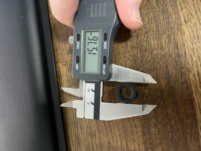

I'm attaching pictures of the filter that the nut will be screwed into, and I need to create exactly the same type of thread on the compressor side.
I'm measuring the external part of the thread, but I'm not sure about the tolerances.
First of all, I figured out that it's a 1.5 mm pitch just by measuring the total threaded length, entering it into Fusion, and then counting the number of threads — it matches a 1.5 mm pitch.

Thanks for the photos. It's difficult to get a detailed view of the thread you're measuring, I was hoping to see whether I could get some more of a clue. i.e. whether it looks like Metric/UN (60°), Whit form (55° rounded crests and roots) or PG (80°), or maybe something else.
Ok, so let's assume for the moment that it's an M16x1.5. With Metric (and UN) threads, a good rule of thumb is that the minor diameter of the internal thread is equal to the Major diameter (say 16mm) minus the pitch (1.5 in this case). This gives a minor diameter of 14.5mm.
If we look at the actual figures for an M16x1.5 6g (external) we have the following:
Mean Major = Ø15.85
Mean Minor = Ø14.137
...and for the internal 6H:
Mean Major = Ø16.203
Mean Minor = Ø14.526
Looking at your photo above that's measuring Ø15.6mm, this appears to be about 0.25mm down on nominal. You've also measured your printed internal minor at Ø14.0mm so this appears to need an increase of 0.5mm on diameter to get that up to that of a standard M16x1.5 thread.
To answer your last point: to measure a thread from within Fusion you can create a sketch on a plane that is coincident with the screw's axis, then projecting an intersection with the body. You can then dimension the resulting sketch.

So I tried to take more detailed photos of the thread on the filter.
 Next
I didn’t wait for a reply and started the print with +1.5 mm for the internal and -0.5 mm for the external.
The result looks like this:
The screw has a diameter of 15.7 mm and it can be screwed into the compressor — it’s not super smooth, but it works.
So I’ll change the parameter to -0.7 mm next.
The nut isn’t fully tightened — I didn’t feel like waiting. So the filter can be screwed into it, but only partially and with some force. I can only get it in as far as shown in the photo.
The measurement shows about 14.1 mm max, and even that takes effort — I’m not sure if I’m measuring it correctly. The funny thing is that the filter doesn’t screw in all the way. Two things come to mind:

Ok, so in those top two photos the thread looks much more 'rounded' that the original photo and nothing like Metric, UN, or any common standard 'engineering' thread. I think you're just going to have to experiment until you get a good fit. By the way: if a thread starts off screwing in but tightens the more you screw it in it is usually due to one or both items being tapered or there's a difference in pitch between the two parts.
