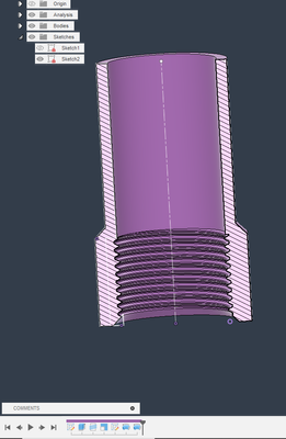

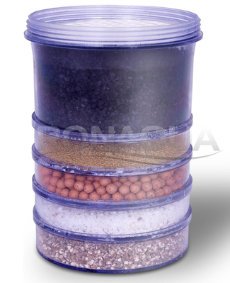

Hello everyone. I am pretty stuck on this model of mine and could use some guidance please. I have a hole in my model that is 86mm in diameter. I need to model threads into it but can't seem to/lack the knowledge of how to model in the ones I need. I usually have no issues modeling threads but this one stumps me. Like I said, I have a 86mm hole, the part that needs to screw into it my my craftsman pitch gauge tells me 11tpi. I cannot seem to find either a conversion or the right type of thread to make this work. Any info is appreciated! Thank you.
Attached are screenshots of my model and the filter that I need to fit it.

mckeehan86live
Thank you. I have no idea how I missed that part. The highlighted hole on the bottom is where my threads need to be.

TheCADWhisperer
Do you have a metric pitch gauge too?
The only inch pitch close to that in 3.75-3.875 inch diameter is 10 or 12 TPI.
What is this diameter (in inch or metric (I can convert))?
Also - a link to a site of the manufacture/model or sale of the filter might help.

mckeehan86live
Thanks for the reply. It is 86mm.

mckeehan86live
Thank you. It seems Fusion only goes up to 2"bsp. However, it looks like it converts to 87.88 iso metric threading. I'll try that. I truly appreciate your help!

HughesTooling
Another option for BSP threads is to use a non uniform scale to increase the diameter without affecting the pitch. If you are doing a lot of BSP threads then creating a XML file will probably be a good idea but if you only need it occasionally scaling might be quicker.
So first create a ring the correct length but with a smaller OD than your part will end up with and add the modeled thread. Because the scale will depend on the diameter you need to to work out what will give the correct offset. So in the attached file with a 3/4 BSP thread the core diameter is 24.338mm so to add 0.1mm offset per side set the scale to 24.538 / 24.338.
Edit got the scale wrong so updated file to 24.538 / 24.338
Then create the rest of the part and consume the threaded ring. Note to add a chamfer to BSP threads you'll need to use a revolve cut.
