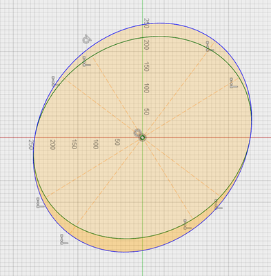

So I designed a panel with the same pattern to propose to the Yoga group using Fusion 360. This is a draft I created with the Fusion User Interface:001a - DRAFT.png
It should be made up of a certain number of ellipses that are inside one another but tangent in two points and rotating at a certain angle. They should create an illusion of a spiral!
The idea is to build this panel with a laser printer to carve it into wood.
I liked the idea so much that I decided to write a script to make it into a precise form. I thought I would be simple work !
If you look at the picture carefully, you can see some errors due to the use of the Fusion User Interface. Can you spot them?
The ellipses do not touch each other (this can generate problems during the print phase). So I tried to solve these mistakes using some solutions through the script, trying to find the exact tangent points.

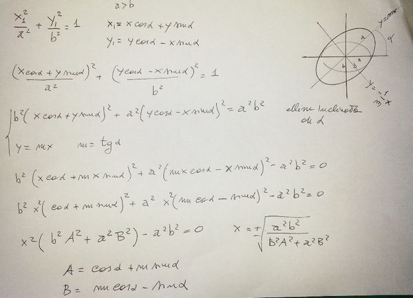

The construction of the whole panel derives from the building of a set of ellipses rotated and enlarged to become internal tangents to the previous ellipse. The tilt (ALPHA) of the ellipses depends on the number of ellipses that one wants to create in a cycle of 360°.
Therefore the first step was to implement a function using the Cartesian equation of an ellipse whose major axis is rotated of a certain angle to the Cartesian axes. In other words, it was necessary to use the mathematical equation to obtain the information needed for the construction of an ellipse inside the Python script with the method: sketchEllipses_var.add(centerPoint, majorAxisPoint, point).002 - Rotated ellipse.jpg

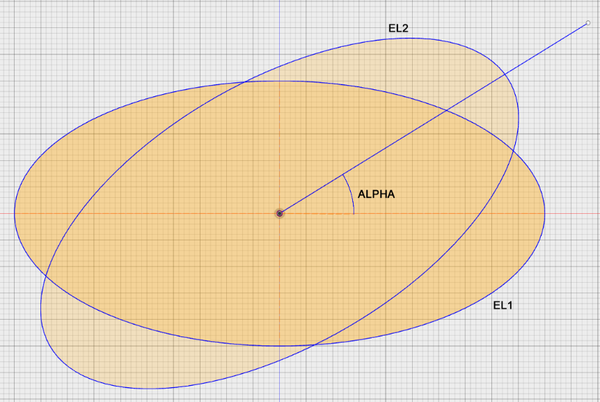

 Such method requires the center of the ellipse, the point which represents the major axis and a generic point of the ellipse (I chose the point connected to the minor axis). The rotated ellipse is built on a new sketch. The two ellipses have been named EL1 and EL2.003 - Rotated ellipse 2.png

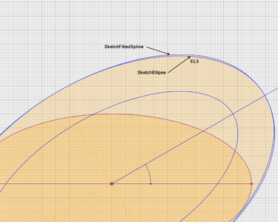

  2. The curve, which looks like an ellipse and which is built with the offset operation, has the shape of an ellipse, but it is NOT a SketchEllipse: it is a SketchFittedSpline
SketchFittedSpline
The second observation, particularly, forced me to better analyze the curves that I created.
A SketchFittedSpline, which looks like an ellipse, doesn’t have the same features:
  • It does not have axes
  • It does not have vertices
  • I cannot make it tangent to EL1 ellipse (!!!)
To create a curve tangent to EL1 ellipse I need to convert the SketchFittedSpline SFS1 to a SketchEllipses. This has been done extracting the main features of SFS1 so that I could use the sketchEllipses_var.add(centerPoint, majorAxisPoint, point) method.
In order to find the major axis vertex, I found the intersection of SFS1 with the ellipse axis. The other necessary point was found as an intersection of SPS1 with the X axis. In this way I can approximate the SFS1 with a SketchEllipse (EL3)006 - KetchFittedSpline 1.png

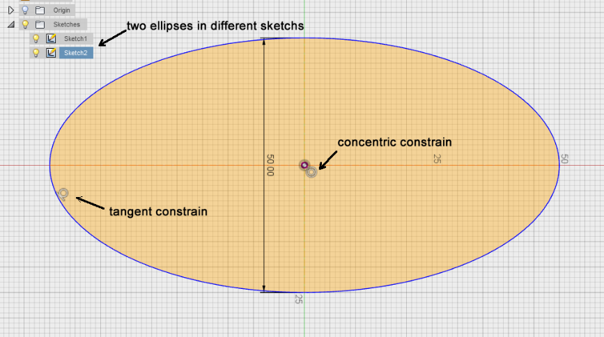

Now it's possible to make EL3 (defined with the variable real_ellipse in the script) perfectly tangent to the EL1 ellipse. To do so,first  I need to constrain EL3 to be concentric to EL1 with sketch2.geometricConstraints.addConcentric(real_ellipse, ellipse1) method, second I need to fix EL1  with ellipse1.isFixed = True and last I need to make EL3 tangent to EL1 with sketch2.geometricConstraints.addTangent(real_ellipse, ellipse1) method .
In the following picture, the constraints used to constrain EL3 to be concentric and tangent to EL1 are visible:007 - Tangent Ellipse.png

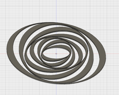

What is left is to create the panel selecting the profiles that I am interested in. I chose to select the external profiles for each ellipse, skipping one every other step.010 - Selection-extrusion1.png
The very last step is the extrusion of all the profiles with the desired thickness so that I can obtain the final result.011 - Selection-extrusion2.pngI can act on the number of ellipses to obtain a denser or more transparent panel. The final effect is to obtain a couple of more or less detailed spirals. The spirals  that I have obtained are of a logarithm type.

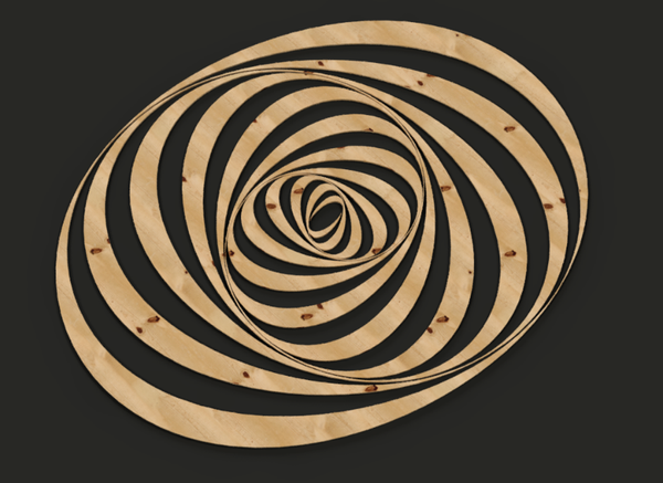

One of the examples has been rendered attributing the Mahogany-Glossy material:013 - Rendered mahogany.png
