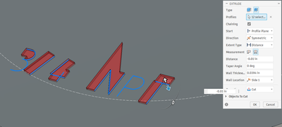

Thin Extrude doesnt work on SS text

JoshuaO_
Can you confirm that it does not work with Wall Location is set to Center?
The screenshot looks exactly as I would expect it to given the inputs, so if this is not the issue, I may have misunderstood the post.
programming2C78B
yes you're correct. Given that I had the first Direction set as Symmetric I thought it controlled the thin feature (i've never seen it before in SW that it allows you to pick a side)
Small bug to report, but the Wall Location RESETS any time you change the (extrude) Direction!
