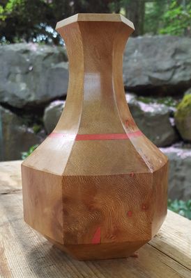

It looks a lot like a piece I just finished:
How are you going to make this?

😁  It's a lot of fun to explore shapes I can create on my rose engine.
