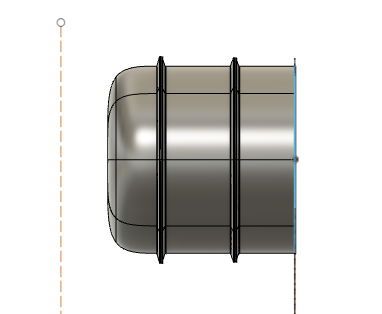

Hi!
I want to have the ribs of the same dimension on the cylinder. How can I obtain this?
The file is included in this post.
The ribs on the cylinderThe ribs on the cylinder
Also, it says the body intersects itself. I can not see where?
Thank you for your help.
Kind regards,
Hrvoje 🙂

Hrvoje-
Thank you, Guenther, but I am in the area called T-Spline modelling. I want to solve the problem in this area.

Message 6 of 8
chrisplyler
Unless you are working on something organic and imprecise...WHY do you want to do it in Form/Sculpt mode?
A shape that has definitive dimensions and angles and positions is not well suited to this mode.
Message 7 of 8
Hrvoje-
I am curious to see if I can do the work in Form/Sculpt mode. Nothing else. 🙂
I thank all forum members trying to put me back on the right road.

Message 8 of 8
davebYYPCU
Use Display > Box mode to find the self intersection.
Or Utilities > Repair.
