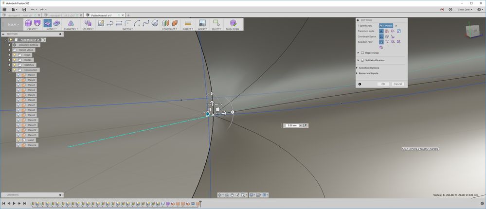

laughingcreek
The answer remains the same.  There will only be tangent handles at creased edges and open edges.  just like in your screen shot.

osman-pasha
Hi. I still think there is a problem with missing tangent handles. Here is a screenshot with creased edge (bold) and no handles at all. For some reason sometimes I get 2-3 handles (out of a dozen points on a creased edge). I can't say when they appear of disappear.
Message 10 of 15
TrippyLighting
All I can say is that generations of Sub-D modelers have created sophisticated models, did not have tangent handles, and did not need them.
Keep your fingers away from the T-spline tangent handles and your models will be much happier!
Message 11 of 15
osman-pasha
Regardless, it looks like a bug to me. Bugs need to be reported and fixed.

osman-pasha
Sure, here it is. Today I have only 1 handle per whole model.
Message 14 of 15
TrippyLighting
I m not quite sure yet, but after playing around some with this model I think this has to do with the number of triangles and N-Gons in your model. There should not be triangles in this model and I believe it should be possible to model without N-Gons as well.

osman-pasha
Thank you for your response!
Here is another thing to consider. On a screencast I create 2 identical cylinders and add caps to them. 1 cap is made with "Fill Hole -> Collapse" option, and it has all the tangent handles, another hole is filled manually with "Insert point" to the exact same topology, but it has no tangent handles. So while the issue might be related to non-ideal topology, it is triggered by some internal state of Fusion that cannot be viewed via topology (same topology - different result).
