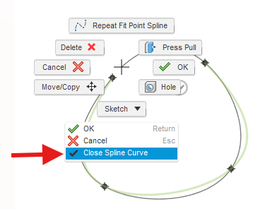

I am trying to recreate a complex surface by using sweep with two orthogonal splines. In the attached image, the roughly semi-circular spline is the path and the long, gentle curve is the profile that I want to use. However, Fusion will not let me select that spline as the profile. I've tried to extrude and pull, but neither lets me select it. I've tried open/close spline curve, but that doesn't seem to make any difference. Is there some way that I can get the spline to be the profile for the sweep? Thanks.

Thank you for your reply. I took your advice and reduced the number of points on the spline to the degree I could. It turned out that the problem was that I hadn’t actually closed the profile spline completely - I had missed the first point by a fraction of a mm. One I got that closed, it worked with no issue.
TheCADWhisperer
@doug_pfeiffer
For future reference, right mouse button Close Spline Curve...
