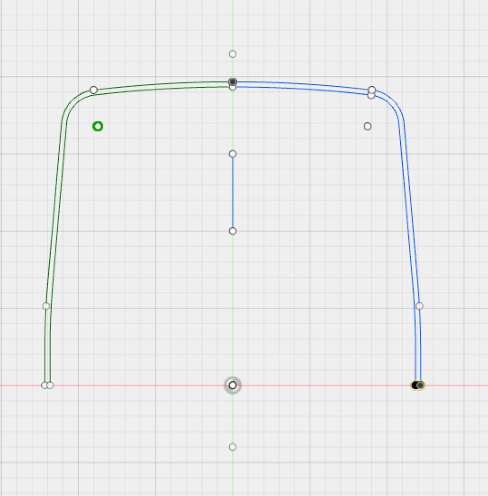

I'm new with Fusion 360 and CAD in general. I want to draw 3D structural bow. The bow is made in one piece. So I draw a sketch for the profile of my bow and at the bottom. I sweep for ~1/3 of my path selected and I have this warning and error message :
Warning: The path does not intersect the profile. For best results, the path should intersect the profile.
Error: The path is tangent to the profile. Try adjusting the path or rotating the profile.
What it's my mistake?

davebYYPCU
Sketch 2 is 3d sketch and no profile exists,
Rail in sketch 1, are two separate paths that are not coincident at the mirror line.
Fix those and you will get a sweep to work.

laughingcreek
The top black dot in your picture means that those lines aren't constrained to each other.  zoom way in and you can see the endpoints don't touch.  I suspect this is happening in other places in your sketch also, but I haven't checked.

TheCADWhisperer
@Anonymous
First thing I notice is that your sketches are not fully dimensioned?
Then I noticed that they are not fully constrained.
And perhaps more complicated than required. (see attached.

chrisplyler
No collection of lines is a "profile" until it is fully closed and shaded in like this...

TheCADWhisperer
@Anonymous wrote:
Another question: Why my line still blue and not black? I put many constraints? No?
Can you File>Export and then Attach your *.f3d file here?
A common test is to simply attempt to click and drag geometry endpoints - this will usually show exactly (using logic) which geometry constraints you are missing?
But I can't help but wonder - why are you creating that closed loop for a Sweep path?  Do you have some other Design Intent in mind?
Did you see a closed path in that sketch for the example that I attached?

TheCADWhisperer
One way to ensure fully defined geometry is to define it at each step.
Create Line 1.  Is it fully defined?  (Thumbtack on sketch.)
Yes, go to next step.
No, try dragging it - observe what is missing...
Create Line 2. Is it fully defined?
Step 1Step 1Step 2Step 2
Once you gain more experience and can predict the expected behavior - you can combine several steps at once.
