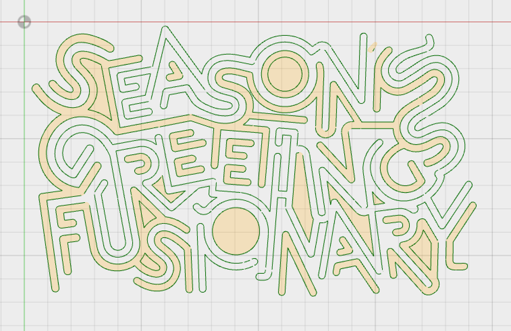

I've got a shape that's down to one layer in Illustrator, and I've exported it in DXP & SVG using multiple export option, and I get the same broken shapes during import. Any suggestions or help? I've simplified the points in illustrator, but still no luck. I attached the illustrator file and image from illustrator. The black I'd like to extrude out of a flat surface. But when bringing it into Fusion, it all get's merged into one big shape. If your able to figure this out, I'd love to know how you did it! Thanks. I attached the two images to show you guys/gals, and the SVG I'm using. Thanks in advance!!

Unfortunately, I've reported this issue(FUS-27614) to development team three times. they are investigating it and I think it will be fixed soon.
If I receive any response, I'm going to get back to you.
And as a workaround, I would like to suggest you to use this way.
1. Open the dxf file in AutoCAD.
2. Explode "the shapes" (command "x")
3. Save as DXF file.
4. insert dxf file to Fusion 360.
5. create a new sketch and use "project" command
Sorry for the inconvenience caused  and if you need more help, please let me know.

Here is the easiest way I know of to solve your problem.
Open your svg in Inkscape (free) and follow the steps in this video.
https://inkscape.org/en/

Here are the fixed files using the method in the video.

God, I love this community, you guys are awesome! Thanks for all the help, especially PhilProcarioJr for the extruded file! Can't think you enough—I was out of my element with this one! Thanks!

Yeah absolutely. I'm installing Inkscape now. I noticed a missing pieces within the "A" so I'm trying to recreate using the video you provided. I'm the sort of person who want's to know how it's done, so I'm starting from scratch. I am having problems running Inkscape—I guess I should have installed XQuartz first. Now Inkscape just opens and closes without any notice. Working my way through that at the moment. But I can't thank you enough for the info, I know I'm on the right track with this.

Hi, I have the same problem. But Inkscape on Mac  is asking to install other platform. So I create a blank doc in Illustrator, pasted the line work I needed (no fill) and exported to svg. Worked. Previously I was using the Asset export palette and it came all broken up. Hopefully will work for all the other elements
