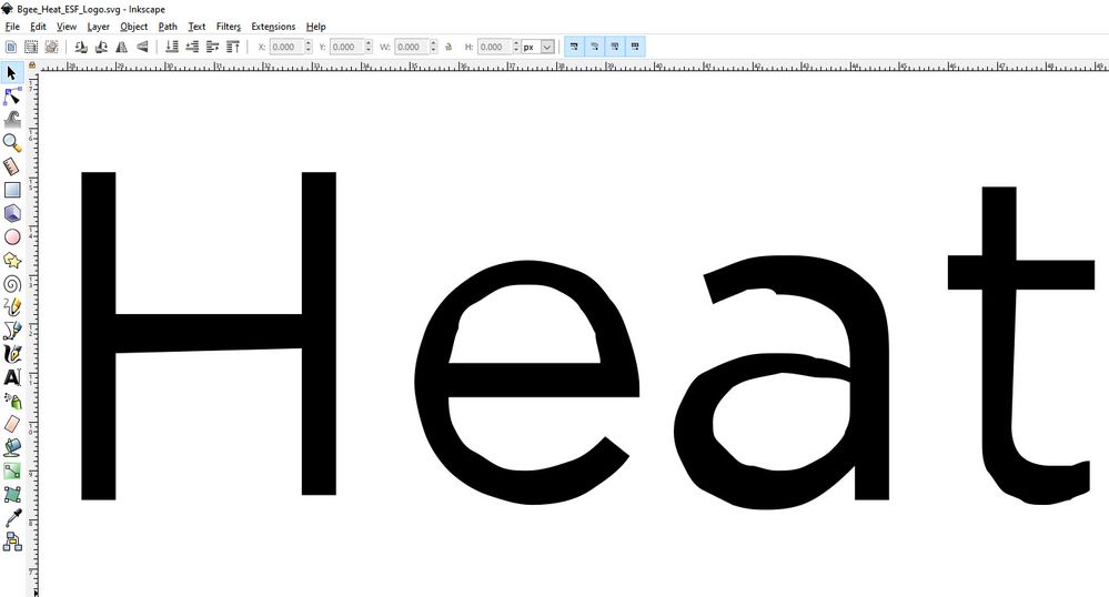

I'm having an issue with an SVG that looks different from the source file created in Illustrator. You can see on the attached that the source is perfectly fine, but once imported the text is deformed. Any idea what this can related to? I've played around ith SVG export options in Illustrator but none seem to make a difference.

I do not own Illustrator but I do use Inkscape.  I opened your SVG in Inkscape and the deformation you see in Fusion 360 appears also.  After saving your SVG from Illustrator, have you closed the file and reopened it in Illustrator, does it look OK.SVG Open in InkscapeSVG Open in Inkscape

Thanks for the file.  I loaded this in Chrome, and got this:
and in Inkscape, and got this:
both of which seem pretty consistent with what I get in Fusion (zoomed into "Heat"):
So, I think that Fusion is providing a relatively accurate translation of what is in the SVG.  At this point, I suspect the SVG export.  Where was your "good" image (Image 046.png), generated?

Thank you, I imported the SVG to Illustrator and see the same thing - very strange. I used an online.Ai to SVG converter and it came out perfect. Must be a broken setting in Illustrator...
