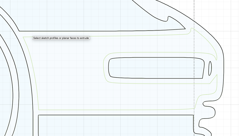

I imported SVG to Fusion360 and from some reason I can't extrude one part of that SVG.
It seems to be closed, I don't have any problem with other parts.

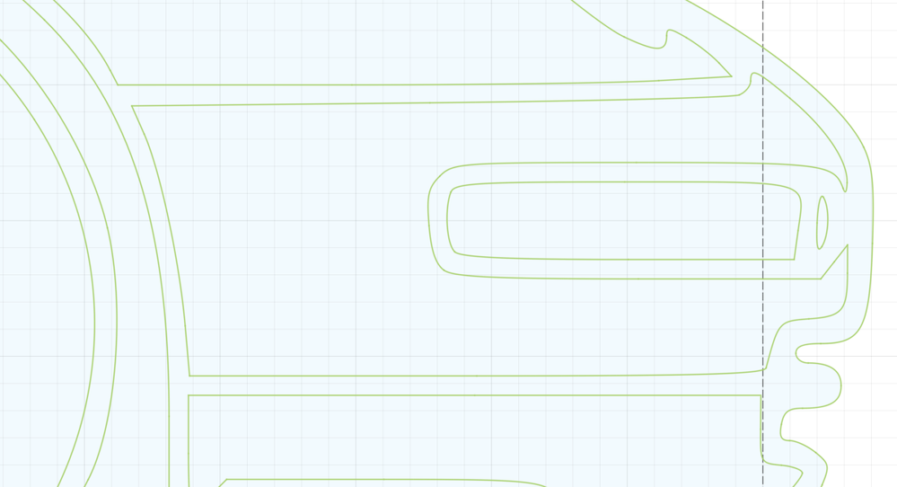

General view of SVG:

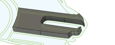

Here I'm able to select like a outside paths, works ok (marked black):

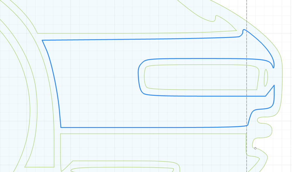

And here is problem part, I'm no able to extrude this selection.
I'm able to select it line by line, but it doesn't highlight while extruding.

Divide and conquer will reveal the issue.

@TheCADWhisperer Sure, attached 🙂 generally I want the outline of this svg, I hope you see the part I mean.

TheCADWhisperer

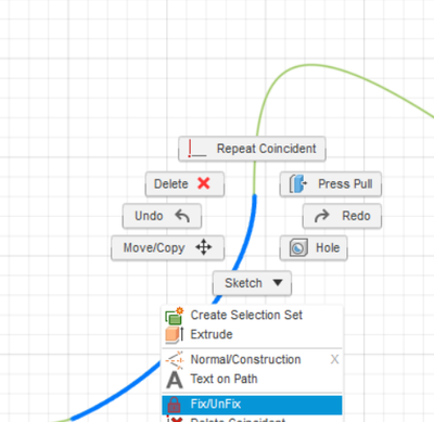

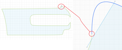

End of this curve.
Unfix the two curves.
Move one a bit.
Add Coincident Constraint.
Actually, better than move one of the curves - simply window select the connection point and click Coincident.
You can reapply the Fix after connecting the endpoints of the curves.

officeLE6D
GREAT! Works 🙂 Thank You.
Are you able to reproduce steps that you made to find that?
Divide and Conquer Technique
1. Delete Extraneous geometry confounding the diagnosis of issue.
2. Sketch a line across boundary - this will reveal which side of the line the opening is one.
3. Drag line around on boundary to isolate the connection issue (shown in my first image).
4. Close the file without saving and go back and fix the original file.
Tip: Often don't need to do Step 1. but I had to in this case because of overlapping profiles.
