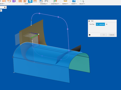

Below are 3 screenshots of me trying to trim a surface with another surface. You can see that I select the trim tool. I then select a surface body. Then I try to select the part of the surface I want to trim, and rather than trim, it adds it to the trimming tool selection.
I've never had this kind of trouble with this before. Is there any chance this is an update bug? Or am I just missing something simple?

jhackney1972
Sometimes it matters where you are selecting the surfaces.  Please attach your model so the Forum users can take a look.  If you do not know how to attach your Fusion 360 model follow these easy steps. Open the model in Fusion 360, select the File menu, then Export and save as a F3D or F3Z file to your hard drive. Then use the Attachments section, of a forum post, to attach it.

jhackney1972
Here is a little cleaner one, timeline is a little cleaner.  The main problem is your loop surface passes through partial rounded edges of the saddle surface.  If you need further help, let me know.

jeff_strater
John is correct - it can depend where you select the surface to trim.  In the video below, you can see that my first attempt failed, but by selecting the surface to trim in a different place, it works.

Bunga777
We have had similar behavior for some time now, and trimming is a bit quirky.
When selecting a surface to trim, it will be enabled anywhere in an area where there is nothing on the backside, but in areas where there is a surface on the backside, it will be added to the trim tool if it is not near the edge of the surface.
サーフェス トリムが機能しない - Autodesk Community - Fusion 360 - Google Chrome 2023-04-08 16.20.45.png
I feel this UI has a little room for improvement, but if you understand the above behavior, this is a problem that familiarity solves to some extent.

TheCADWhisperer
@TrippyLighting wrote:
...in even simpler situations than this, it completely fails ...
There is definite room for improvement here and that needs to be recognized!
No question this selection issue could be improved - but I would be interested in examining a case where unambiguous selection is not possible.
I would like to experiment with selection strategies.  It appears to me that Fusion is seeing geometry in what I'll call z-depth into the screen (not the XYZ, I don't know if there is a technical term for this).  If I orient the view such that there is no ambiguity it seems to work reliably.  I can image that there are cases that such ambiguity is not so easily overcome as in my video...

Thanks to everyone for taking the time to have a look at this. Selecting the surface to be trimmed in an "unambiguous" location seems to be the trick that I was overlooking. I have been using F360 for quite awhile but it has been a bit since I used surface trim. I don't remember this surface ambiguity being a problem in the past. It feels like a new "feature".
Either way, at least now I know that I wasn't losing my mind.
