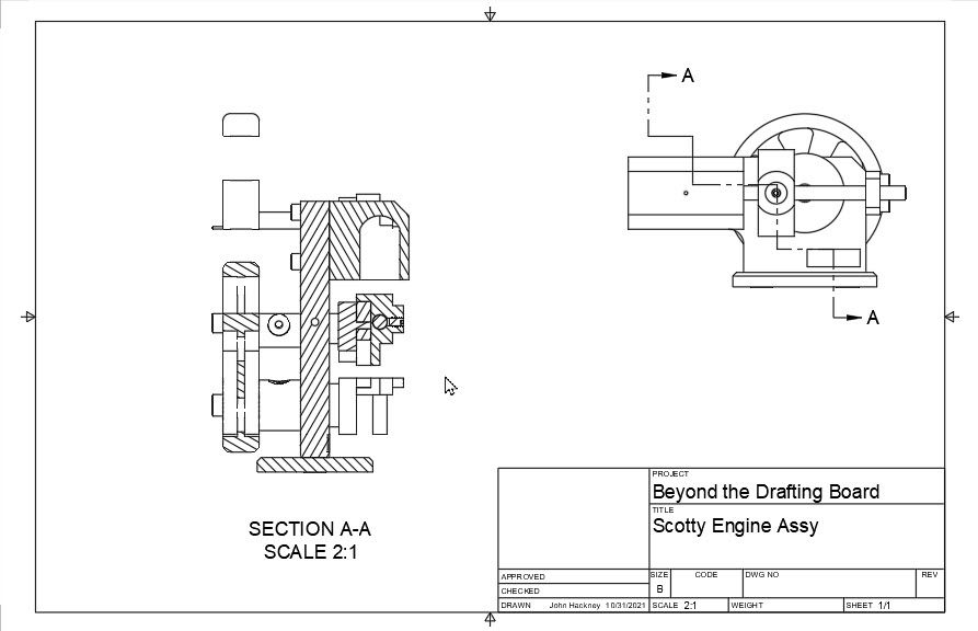

I have created a mold base and would like to do a stepped section view through multiple components.
Can't find out how to do that.

If I understand what you want, it is possible in the 2D Drawing Environment but not in the Design Environment .  Sorry about the example, I grabbed the first thing I saw to demonstrate.

That is exactly what I am looking to do.
Looking at your drawing gave me an idea and I figured it out.
Thank you.
