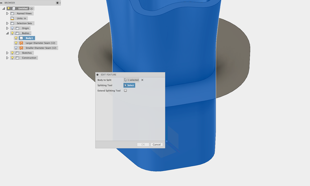

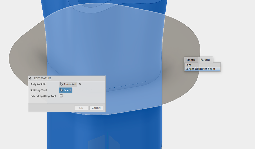

The solution is pretty simple and a UI usability issue in Fusion that can be quite annoying.
What you do when you select the split tool is select a face of the body and not all faces of the body.
to do what you want do this:
1. select the body in the browser Larger Diameter Seam has 12 faces!
2. click the any face of the Larger Diameter Seam in the 3D View and hold the left mouse button pressed
A selection UI will appear and in parent select the body.

Really helpful. Thank you so much.  A little clunky but its great to be able automate this with a parametric splitting surface.
