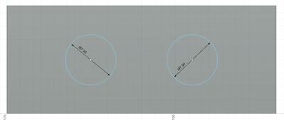

I have a rectangle that I am trying to place two cylinders on the side. I want these two cylinders to be center on the Y axis of the rectangle as well as equal distance from each other and the edges of the rectangle.
Surely there is a quick way to set these measurements without doing any crazy math in my head.

Hi @landonRZADR ,
We can use Sketch constrain to Symmetry.
Refer Below video
https://autode.sk/3shGVN3
Let me know if you are looking for the same or something different.
If my answer helped, please 'Accept Solution'

personally I would avoid the symmetry constraint.  it makes your sketch heavy, and there are to many quirks/bugs associated with it to keep track of.
you can use construction lines set to be equal to each other.  I've attached an example.  you'll notice if you drag around the size of the rectangle, the spacing between circles and edges remains equal.
