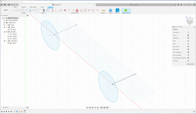

Hi all,
I'm trying to constrain the center of a circle that I've built on the surface of a construction plane with the point formed by the intersection of the plane with an orthogonal line (see image). But nothing works: neither the snap when I draw the circle, neither the "coincident" constraint, if I try to apply this command after drawing the circle. It seems that simply F360 doesn't consider the intersection point as a "interesting item" for building another object, or make some other work with it.
How can I resolve? And, generally speaking, I don't understand the logic that F360 put on this type of issues. Because I'm absolutely secure that there is a logic. Someone can explain me?

if the sketch (sketch3?) is active, you create a projection (P) and click on the point in sketch 1/2. Then a point appears in the active layer, which you can use as position for your circle.
Maybe you share your file?
günther
I've done follow your tip. Thank you again.
So the logic is: "A point  exist in a different sketch only if projected from the sketch where it is created?". Is that correct?
g-andresen
YES!
Maybe this setting in the preferences is an option for you.
But be careful if you do not want the geometry to be projected automatically.
