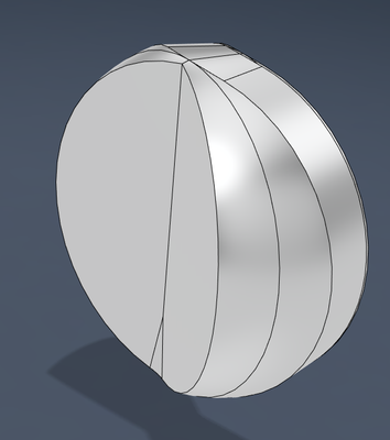

I have a solid which is the result of a body rotated around an arbitrary axis (the solid consists of 40 merged bodies):
I want to smoothen the solid's surface, to get rid of the steps between the bodies. What is the best way to achieve this?

Have you tried Solid Sweep?  This option to Sweep allows you to sweep a solid body along a path, and does the "smoothing" for you.  Create a circular path, instead of an axis to Revolve around, and use Sweep, selecting "Solid Sweep" as the option.

Is there a way to control the angle around the rotation axis? For the rotation method in the first post I used  +/-20°.

The easiest way to control the sweep is using the path.  Just make a circular arc that goes 20degrees in each direction. You may have to do two solid sweeps - I'm not sure just now whether solid sweep supports two directions in one sweep.
Unfortunately, I don't have time right now to play with your model, but it should be relatively straightforward.

What you attached isn't a single solid.
Attached is a version with a solid sweep, that took some workaround past a solid sweep fail.
