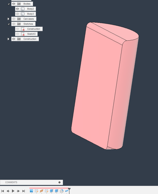

Hello
I am trying to get a smooth transition into the end arc of a pipe sweep as per the attached drawing (area circled in blue)  I am unable to use a fillet  what's the best way to approach this.
many thanks

Here's one way.
Create a body with an edge that follows the centre line of the pipe.
Then add the pipe. See attached design.

@jdpreynolds,
Attached is a variation of @HughesTooling and @wersy using a Fit Point Spline for the perpendicular transition

thanks for you reply's the finished result looks great.  I will give this a try
