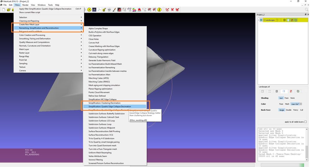

I'm really new to this whole environment, but I just want this file to be stacked based on the cardboard thickness settings. I'd really appreciate some help, considering the due date is in two days. Below, I've attached the stl file. Thanks.

Hello @Anonymous
I turned my attention to this specific case.
The model you are presenting is a model composed of several faces.
I downloaded your file and performed the following processes:
I transported your file to the software: MeshLab
After that I performed the following steps inside the platform: (you can view the images).
So I exported your file as a mesh again with the reduction of implemented faces so the SLICER software can recognize your file.
As your model is complex to be interpreted I was able to apply 2 techniques:
Being them - Folded Panels and 3D Slices
All the images and files of the piece are attached!
I hope this can help you in your work!
