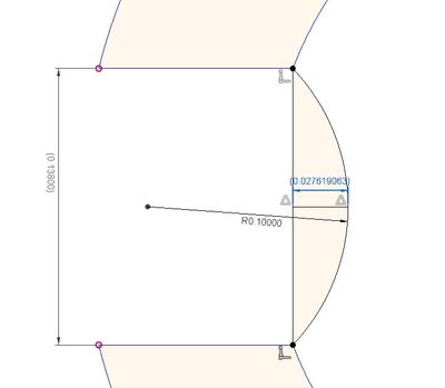

I've attached a sketch that I'm working on.  The open section on the left side of the part is .138 wide and I'm trying to create an arc from each of those endpoints, winding up with a radius of .100.  The arc rises above the work by .035.
I'm able to create an arc from each of those endpoints, but I can not control the radius that I want to end up with, .100.  I select the right side face when I begin the sketch and when I do create an arc, it's out in space, not at the end points between the .138 width.  I also can not control the .035 height that I want.
Any suggestions?  After creating the sketch, I want to turn this into a solid.  After I figure out the arc issue, I need to extend the cylinder down by .165.

It would help if you used CAD definitions for directions and planes.  Above could be on the Z axis or the X axis depending on how you view the drawing.  In any case create an offset plane at the point you want the arc.  Add a sketch to the plane.  Project the endpoints from the original sketch. Use a 3 point arc, selecting the endpoints and any midpoint. Create a radius dimension on the arc and set it to .100.  Note: The height of the arc will be 0.27619063".  It is not possible to create a .100 radius arc with a .138" base line and have the height equal .035.
Note: This is shown on the XY plane, but it could just as easily be done on the YZ plane.
