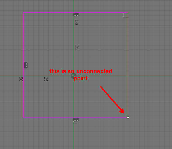

Hi @Anonymous.  You must have a break in your curves somewhere.  It's a bit hard to tell from just the picture, especially because the sketch geometry is selected, so all the points are drawn.
There are a couple of techniques to fix this.  First, if nothing is selected, you can see "free" points (meaning points that are not connected by 2 or more curves), where normally these points are not drawn:
These points can be joined using the Coincident constraint, or by just dragging the point so that it snaps to the other point that is also there.
Second, use the technique shown by find-leak-in-sketch-geometry.  This is an easy way to find out where the disconnected parts of your sketch are
Or, if you share your model here, others will jump in and help.
