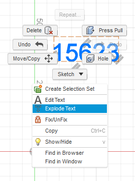

One can explode text by right clicking on a sketch text object while in sketch mode and selecting the "Explode Text" option in the dropdown menu.
- Erik
