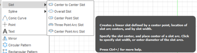

Hi!
Please have a look at this very simple design : https://a360.co/3FD7rsh
If you change the "length" in "user parameter" to 280 mm (instead of 320 mm) the body length will not change as expected : If you edit the sketch you'll see that there's a "coincident" constraint that broke but the sketch is still displayed as fully constrained.
Other strange behaviour : if you change the "length" in "user parameter" to 100 mm, it'll work fine.
Thanks.

I would have used the Slot command to create this sketch - far fewer constraints needed.
I (mostly) avoid Symmetry constraints.
If you drag the point it does update, but I would not create a simple sketch like this with so many constraints to solve.  Centerpoint Slot is much more computationally efficient.

I know what is going on here:  the distance delta that you chose (40) translates in the dimension (/2) to exactly equal to the diameter of the end circle.  You can see this if you add in a construction arc that shows the rest of the circle:
So, when you change length to 280, the center construction line lies exactly on that phantom arc:
Internally, Fusion treats sketch constraints as if they are to the "infinite" version of the geometry.  So, coincident to an arc is really coincident to the full circle.  So, what I suspect is going on is that the sketch solver is seeing this as not having violated the coincident (actually midpoint) constraint, it just is confused about which half of the circle is visible.  If you go step-wise, in anything less than 40 increments, it works.  320 to 300 to 280 works fine.  It's just that delta of 40 that causes this problem.
Yes, it is a bug.  I will create a bug for it.  But, @TheCADWhisperer is also correct - you are working way too hard to create a slot shape.  Symmetry and midpoint are both constraints I tend to avoid, unless there is no alternative, just because they are more complex, and the solver can struggle with them.  There are many other ways to create that slot shape that does not have this problem.  Until that bug is fixed, I'd use another method.
