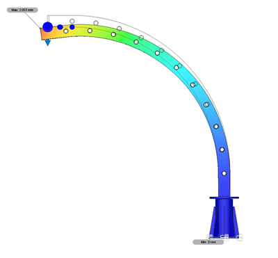

I am looking to design a Davit arm with long reach for offshore wind farm. with a few more changes I can get greater than a safety factor of 3 so no problems there. My question is how to determine the pressure on the bearings shown in red (simplified). I do have other iterations of the arm but still need to find out how to get the value for the bearing/bush. Any help would be really appreciated. I have 57 to make so need to get it right lol

really appreciate your assistance. I think I understood what you said and found the Offset Bonding contact. but I don't get the result I was expecting. Before I added the bearing and shaft, I ran the simulation and had a safety factor of 3.8. then I added the shaft and bearing with the off set contacts and I get a safety factor of 15 and only 0.5MPa where as your value looks more realistic. would you mind having another look at my simulation to see where I have gone wrong

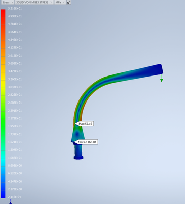

I noticed a strange behavior in your model. The reaction forces are not equal to the applied load. Of course, they should be in the balance. Messages from the solver suggest, that it can be also connected with curved geometry. I calculated this model in Autodesk Nastran, and there I get results, what I expect (reaction forces are also balanced).
I need to investigate your case more thoroughly. A nonlinear study could be a solution for that issue. I will check it out, and let you know.
Below, I attach the model from Fusion, which I adjusted, so you can see what boundary conditions and contacts I used (but as I mentioned, something is wrong with the results, and it needs to be investigated).

The good news, I managed to perform the simulation correctly. The troubles were generated by enabling the "Remove Rigid body modes" option. In your case, we don't need to use it, because the model is correctly supported, and we don't expect that some components can "fly away". When I deselect this option, I get much better results, and after checking reaction forces, they are balanced related to the applied load.
Here is a model with incorrect and correct results (the differences are noticeable):
https://a360.co/3kX6b7m

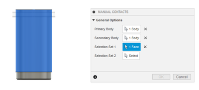

Another question: Manual Contacts

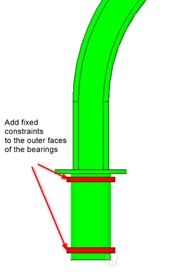

back to my bearings again, when in the general options selections is my "primary body" the shaft or the bearing like wise is the "secondary body" . I have been choosing the shaft as the Primary and bearing as secondary.
then I get to pick selection set 1 and 2, it only lets me select the shaft for selection set 1
and the bearing for selection set 2
I chooses separation  and check the auto activation distance
is that the correct workflow?
then I have to apply a constrain which I use the fixed on to both bearing rings see below. again is that correct.

Regarding the contacts, in your case, you should already have automatic contacts between shaft and bearing. Just change the type from bonded to separation (software creates bonded contacts in locations, where various bodies are touching each other).
I see you try to create manual contact between the shaft and the outer face of the bearing. Since we want to simulate real interactions, we should choose the inner face of the bearings, because there we will observe the interaction.
Regarding the constraints, since we have separation contact (the movement between faces is allowable), we need to be sure the model is stable. Notice please, the shaft can move along its own axis. We need to add an extra constraint, it can be an edge which I marked as red in the screen below.

As I can see, you have only one fixed support on the bottom face of the shaft. In this case, you will not get a reaction on the bearings, because they will behave like the shaft (if separation contact is defined, the bearings will slide over the shaft). You need to add additional constraints.

I have attached my model. one thing I cant seem to do is when you do "auto contact" then edit the bearings to separation I cant see how to pick the inside face of the bearing as you mentioned. but I can do it when you do the connection manually.

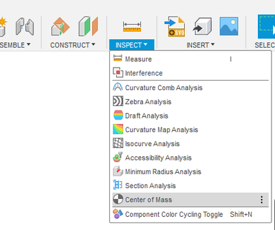

finally when the davit arm is installed, it would be lifted and dropped in to the bearing. How can I find the center of gravity to mount a lifting eye for the crane to lift that will keep the shaft vertical

To find the center of gravity, you can use the tool in the design workspace called "Center of Mass" under Inspect icon.
