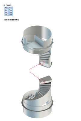

I have a simulation of a staircase with holes in the baseplate for bolting to the floor. There are a series of holes and depending on the position there will be a negative or positive reaction force.
I would like to create a report that displays the reaction force of each individual hole.
When using the Inspect > Reactions i can select the face of the hole giving me the reaction force i need. But upon selecting multiple holes (with positive and negative reactions) i can only get the sums of the reactions and not for each hole individually.
For calculating the required anchors i need to report the reactions in each individual hole.
Selecting one hole gives me the information i need (Z component of the force)
Selecting multiple holes gives me the combined reaction force of the hole but i need the information of each hole individually:
Baseplate with al the holes:
Total view:

As you've discovered, the reactions in the report are listed per constraint, however there's a workaround.
I realize this is now a bit inconvenient with so many holes, but if you could apply a unique / independent constraint per hole, after re-solving, the report should then display the reactions per hole independently.

Is there an option to indicate the position of the constaint more clearly? With an arrow for example?
henderh
Hi @mathieuD8XG3,
We can force the glyph size to be larger in the user preferences for sim, but we cannot change the color or indicate the (x,y,z) position more clearly in the report. I'm not sure why in the report I generated for the simple case, the constrained entities are highlighted blue, but I don't see it in your screenshots.
If you'd like to visualize which fixed holes are pulling vs pushing to balance the applied loads in static equilibrium, we can display the result type for the Reaction vertical component. In my example, blue-ish colors indicate this direction that we can use to visually scan the model.
