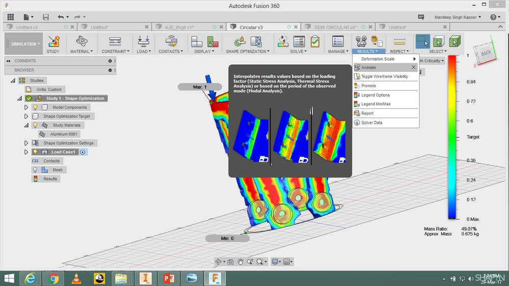

A image appears in the final video while trying to animate the simulation with the animation function provided in Fusion 360.
Below are the screenshots of the video which is obtained from the animation function. It can be clearly seen that the same picture appears in the complete video. Screenshots provided are of 00:01, 00:02 00:05, 00:07 & 00:10 sec. of the video

It looks like you are trying to animate the results of a Shape Optimization Study.  The results of Shape Optimization have nothing to animate.  Only Studies that have Displacement results, such as Static and Nonlinear Stress, Modal Frequencies, Buckling, and Event Simulation.
Since Shape Optimization does not have Displacement results, the animation appears to not change.

When I animated the shape optimised body, the material of the body kept eliminating till the target mass(e.g- 50%) when I clicked the play button.
So that animation of material removal could have been recorded.
