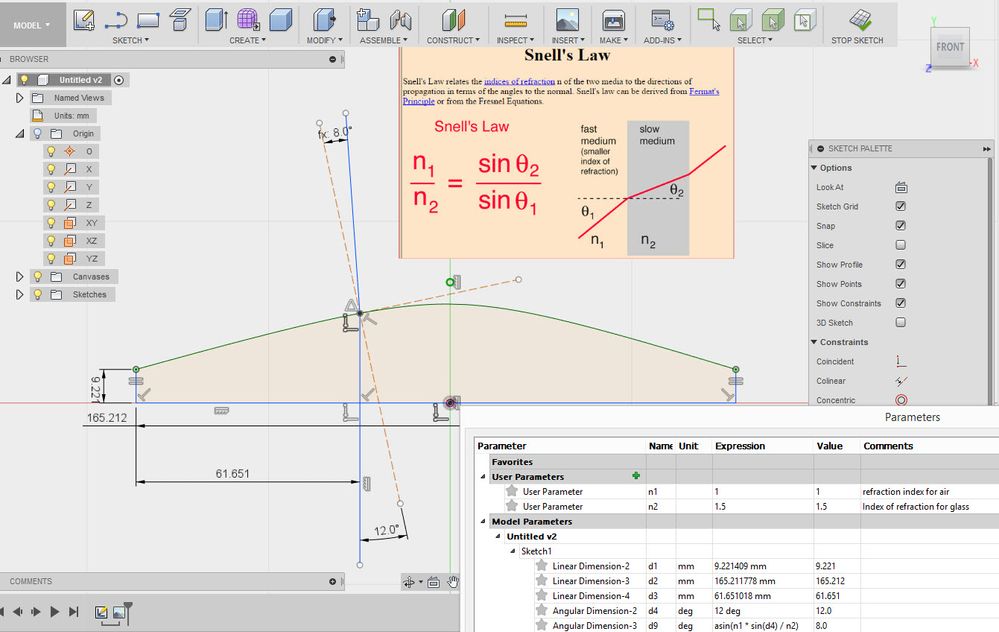

It would be painstaking, but I'm wondering if you could use a sketch and create lines to represent an incident and reflection paths.  Geometric constraints could be used along with a construction line that is tangent to the reflector at a point of interest.  You could then adjust the location of the sketch point used as the reflection point, to view different angles.
This may be simplifying things greatly, as you may need to incorporate Snell's law to account for the transmission through different media (entering glass from air, for example) to increase accuracy.

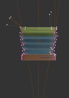

I needed the opposite effect in a lens hood as I wanted to model blocking light from outside the field of view hitting the lens. I used the mirror command to show the light paths:

Transmitting through a lens version is attached.
A colleague and I were working on a more elegant approach, using rendering and an emissive appearance as the light source.  [Edit: I didn't notice that TrippyLighting has already gone down this road before]
