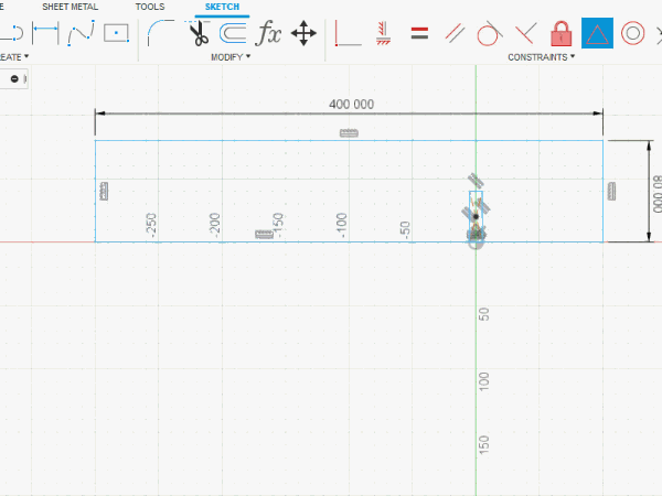

here´s one way:
My recommendation:
create parameters for thickness, height, width ...
günther
