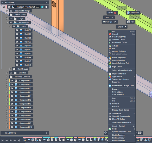

Select the Component you want to work with (blue in Browser) right click menu, has a menu option (if applicable - that there are articles to see) Select Referencing Joints, will do as you ask.

Ahh! I realized what happened. This button "Select referencing joints" is no longer there. But instead, when you select the component its relevant constraints are highlighted in the Relationships folder automatically.

It's still there.

Did you find way to highlight/display all the constraints (not the joint) relative to a component in an assembly?
I do not have this "select referencing joints" which seems logic as mine are constraints. But i do not have those constraints highlighted in "Constraints" folder in the browse when i select my component.
