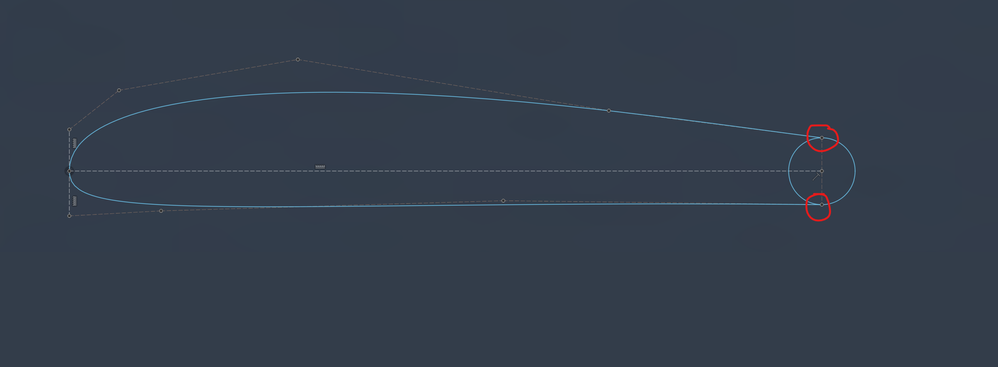

There are problematic. The sharp edge @jhackney1972 has pointed out is one, although the sharp edge itself is not necessarily the problem. THe problem i that there are two faces the transition from a curvature continuity to sharp. That is always a problem.
Then the  lofted surfaces in the highlighted areas also have strong curvature that is too small to offset 1.5mm.
A 0.1mm rounded offset works, increasing it to 0.2 takes quite long to compute and that's about it.

@TrippyLighting, I'm not sure I can follow. I know what surfaces you are pointing out, however I never had an issue with that. My crude lofted body above also reiterates this. There's also curvature that is abruptly transitioning to a straight face.
So let me rephrase the question a bit: What would you change so that the shell is possible with a bigger radius?

I don't understand what surface transition you are imagining here. It implies tangency, but there is no constraint for it in the sketch. A rail that is tangent to a loft profile is generally not such a brilliant idea.
The shall command creates surfaces that are offset from the surface normal of the originating surface. In that area, the shell command would have to create a very sharp-edged surface if used without the rounded option.
Not only is this sketch not dimensioned, but it also requires at least tangent constraints in the highlighted area. Otherwise, near-tangent conditions also can effectively prevent shelling.
With the sketch inputs fixed, and some changes to one of the loft rails, and enabling the 'keep tangent edges' option on the loft (essential when profiling sketches contain tangent constraints), this shells to 1.5 mm. It ain't pretty, but it works.

Beginning with your solution @TrippyLighting. I added dimensions and also added tangent constraints in the sketch areas you highlighted here m_eckhard_0-1749324364654.png
and here
m_eckhard_1-1749324380937.png.
However, I'm not able to see improvements regarding the shell. Yes - adjusting this guide rail
helps. But I'm not sure why a vertical constraint is not helping here which in my mind would make the spline (red) perpendicular to the horizontal, projected line (purple). Instead you chose to tilt the control points of the spline to the right. The reason of which is not clear to me.
